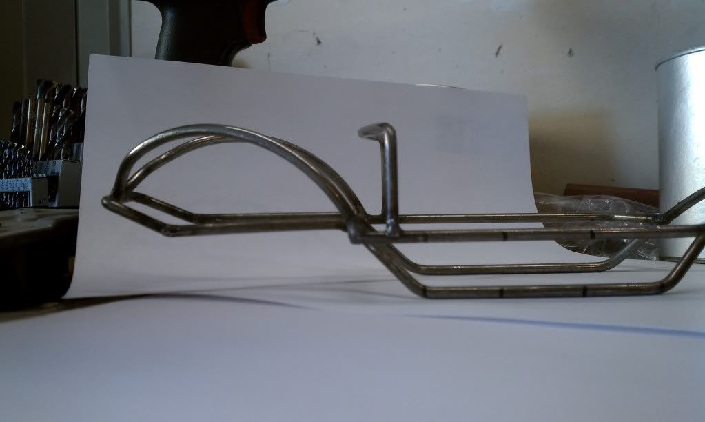

Main frame rails bent up:
Got the two sides joined together and squared up:
side view:
As you can see on the front of the frame, I already made a change to the chassis from the original design.....:haha: I got a thing for that bend-up in the front.:redneck:
Okay, now I am out of material....:booo: This is as far as I can go tonight, till I get some more steel tomorrow......
Got the side rails built and installed:
Coming together!!!:cheer:
Poke fun all you want....... Your Wraith won't know what hit it......:fawkdancesmiley:

I was a little worried trying to make the curve both the fenders identical, so I came up with a bending die. Found an old Toyota pulley I had laying around, and the crotch of the pulley is perfect for bending 3/16 and the diameter was near perfect for the curve I was trying to achieve.
Here is my new tool
In this picture you can see at the top of the pulley, where I drilled a through hole and welded a pin in it to act as leverage for when I am bending. Worked flawlessly!!
Here is my final product.
From the front:
I must have really caught the bug today......
Got the lower windshield bar/A-pillar done:awesomework:
Top view:
Time for that little piece that connects the fender to the A-pillar:
I got anxious and wanted to do the roof line, so that was my next step:redneck:
From the front:
Scootin right along!! I am assuming it will be sitting on it's own weight by the weekend......
