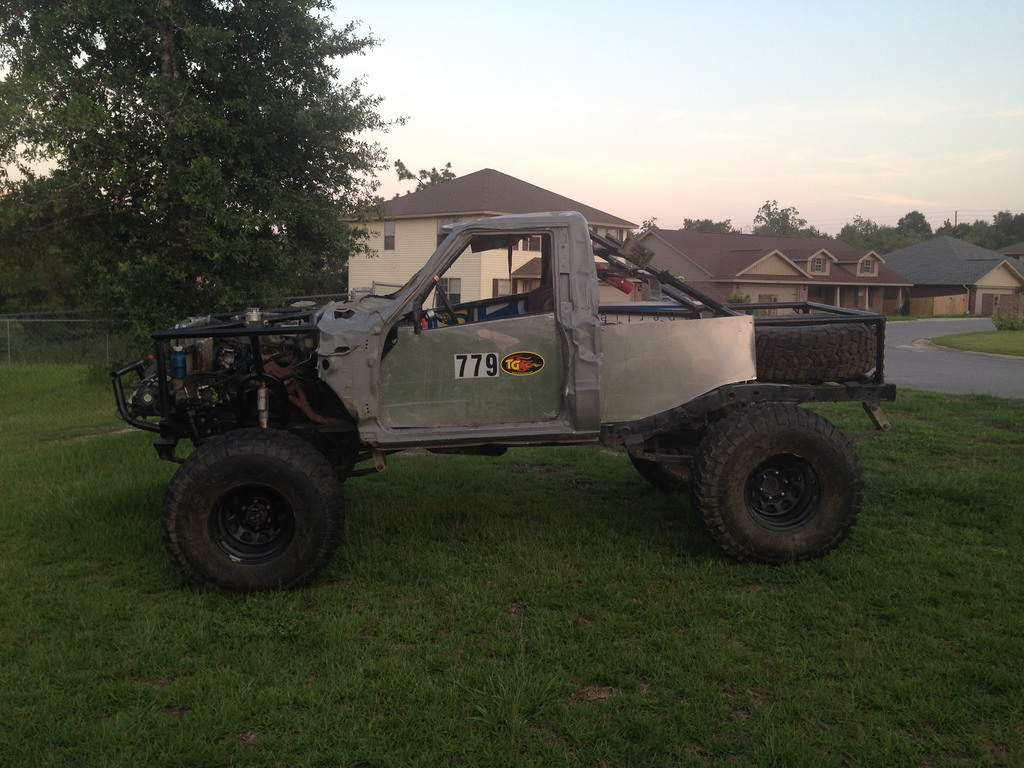

Hi my name is Tom and I like to wheel. I am making a big move from Florida to Washington. I will be continuing my build here. I have been wheeling the southeast for a while and recently got into racing. Looking forward to seeing what the PNW has to offer and doing some wheeling.
Truck specs-
86 Toyota 4Runner with a 86 truck cab
35" BFG KM2s
SAS
Detroit locker f/r
Hydro assist
Marlin ultimate dual t-cases
22re on propane
internal cage

Got some aluminum skins put on.
